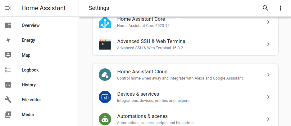

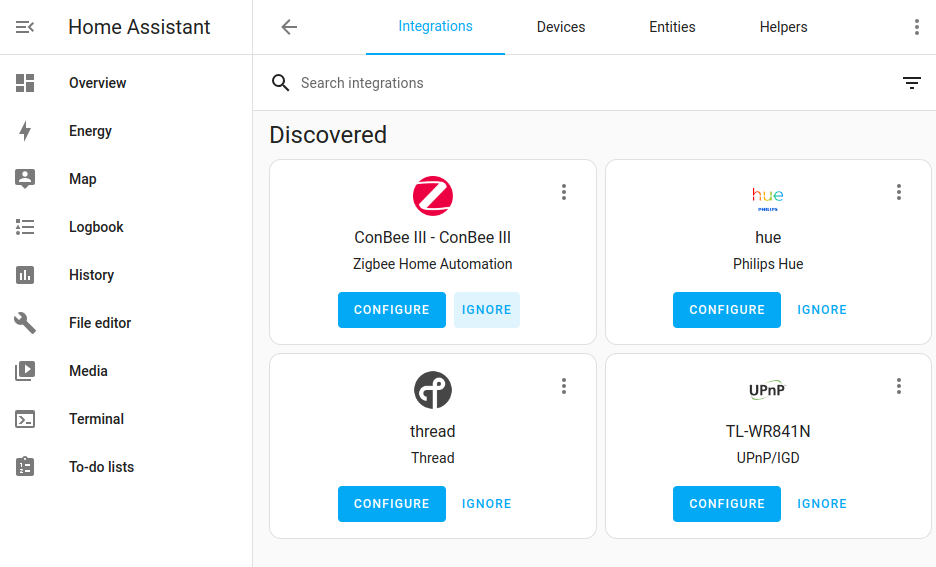

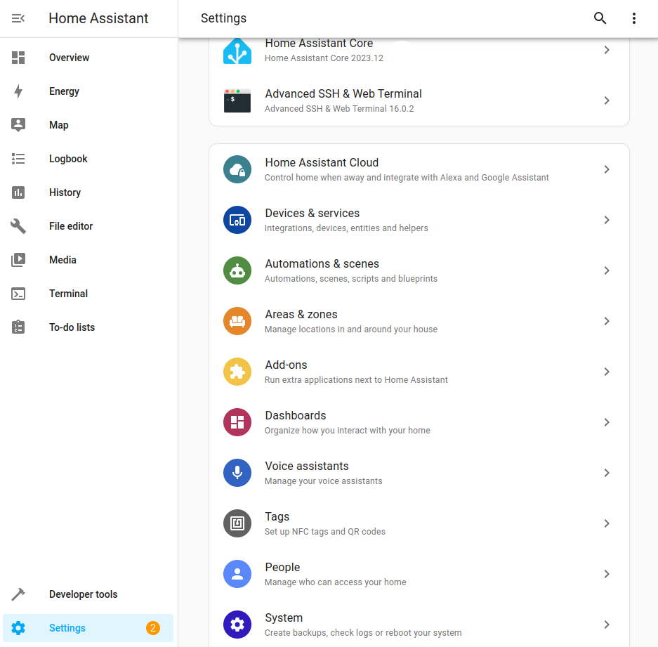

  1. Login into Home Assistant web interface and open the Settings section.
    HA settings

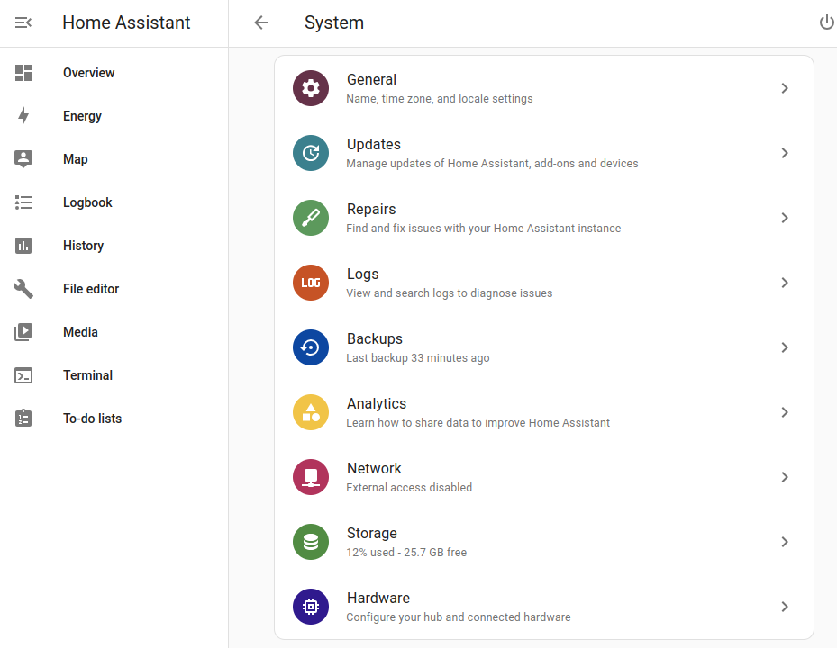

  2. Open the settings of the System and switch to the Updates section.
    HA settings system

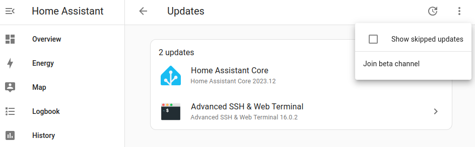

  3. Update the Home Assistant core at least to 2023.12.0.
    HA core version
  4. Open Devices & Services in the settings section.
    HA devices and services
  5. Search and add the ZHA service.
    HA ZHA

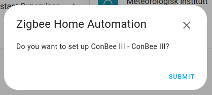

  6. Configure the ZHA integration to set up the ConBee III.
    HA ConBee III integration

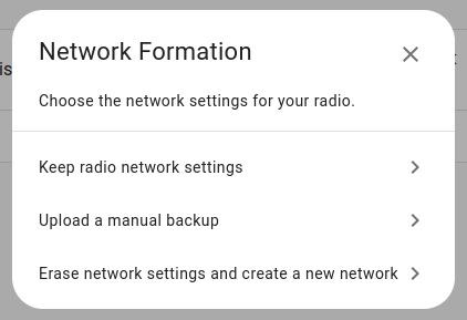

  7. Define the network formation: keep network settings, upload a backup or create a new network.
    HA network formation

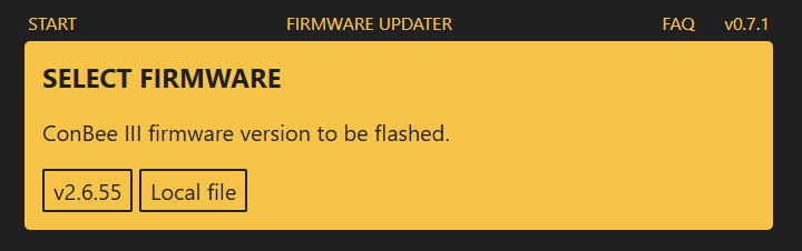

Update directly in the web browser
The ConBee III firmware can be updated in the web browser. Currently, only Chrome and Edge are supported.
  1. Open the Online Firmware Updater
    ConBee 3 Webupdater
  2. Connect the ConBee III to your PC/laptop
  3. Perform the update
Done!

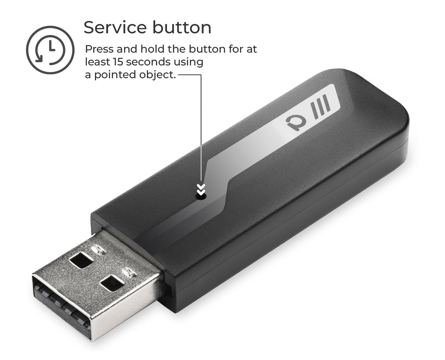

Factory reset
The ConBee III could be reset to factory new settings by using the integrated service button.
Reset to factory new
The following parameters are reset to factory new settings:
