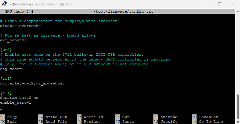

  5. The serial interface for communication with the RaspBee II must be activated in the config.txt.
    sudo nano /boot/firmware/config.txt
  6. Add the entry enable_uart=1 and save config.txt.
    Enable RaspBee II UART

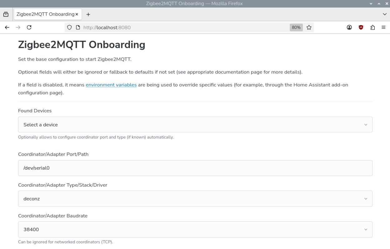

  8. Open the web browser on the Raspberry Pi and start the Zigbee2MQTT onboarding via the address http://localhost:8080
    or
    Start Zigbee2MQTT onboarding via the Raspberry Pi using an external web browser from a PC or laptop:
    Method 1: http://raspberrypi:8080
    Method 2: [Raspberry_Pi_Hostname]:8080
    Method 3: [Raspberry_Pi_IP_Address]:8080
  9. Enter the connection port /dev/serial0, the baud rate 38400 and the adapter deconz. RaspBee II Onboarding Selection Adapter

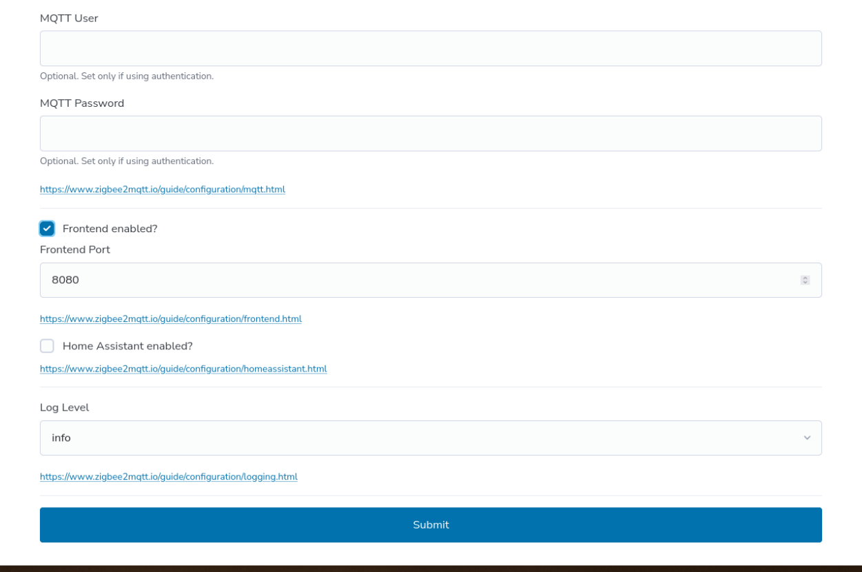

  10. Activate Zigbee2MQTT frontend and click Submit. Activate RaspBee II Onboarding Frontend

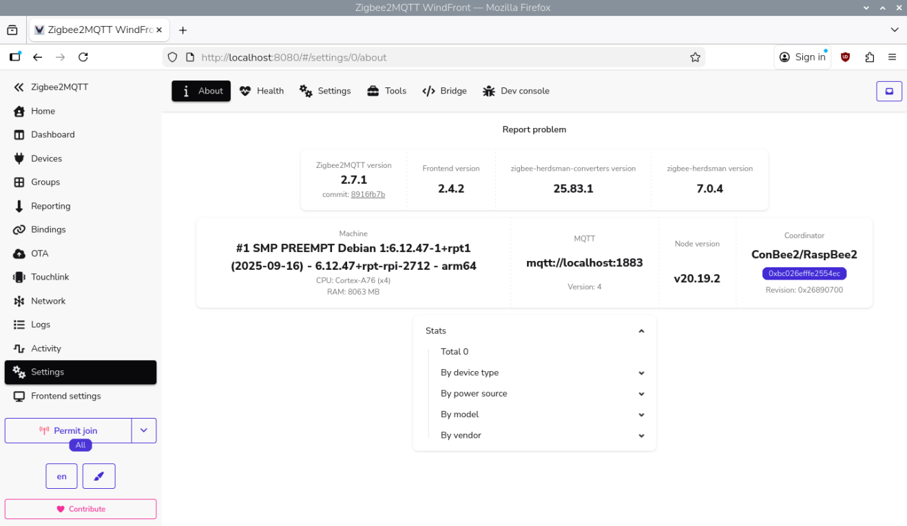

  11. After about 30 seconds the Zigbee2MQTT frontend will be loaded Zigbee2MQTT frontend
The first Zigbee devices can now be trained via the web frontend.

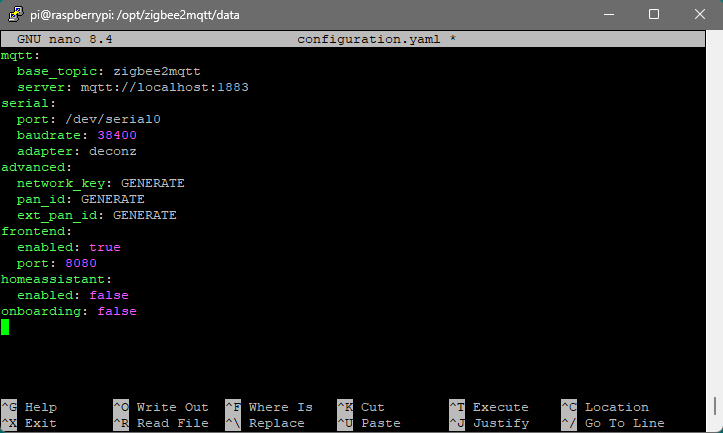

  9. Edit configuration file configuration.yaml
    nano configuration.yaml
  10. Enter the previously determined connection port, the baud rate 38400 and the adapter deconz and save the configuration file
    mqtt:
        base_topic: zigbee2mqtt
        server: mqtt://localhost:1883
    serial:
        port: /dev/serial0
        baudrate: 38400
        adapter: deconz
    advanced:
        log_level: info
        network_key: GENERATE
        pan_id: GENERATE
        ext_pan_id: GENERATE
    frontend:
        enabled: true
        port: 8080
    homeassistant:
        enabled: false
     onboarding: false
    RaspBee II adapter configuration

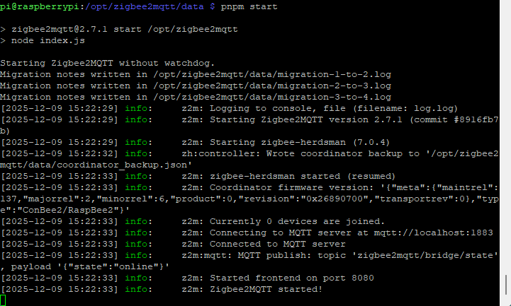

  11. Start the Zigbee2MQTT application. If configured correctly, no error messages should appear.
    pnpm start
    Zigbee2MQTT Start
